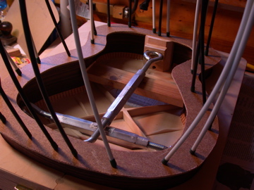

I've seen holes drilled in the mold near the sides to allow the spool clamps to pass through. Seems like this would be a pain at glue-up time though, IMHO.
I and others have used go-bars. My setup looks like this:
edit: man these guys post quick!burbank38943.7184606481

[QUOTE=burbank] I've seen holes drilled in the mold near the sides to allow the spool clamps to pass through. Seems like this would be a pain at glue-up time though, IMHO.
edit: man these guys post quick![/QUOTE]
PAT, YOU'VE GOT A BIG HOLE IN YOUR BACK PLATE

[QUOTE=Rod True] [QUOTE=burbank] I've seen holes drilled in the mold near the sides to allow the spool clamps to pass through. Seems like this would be a pain at glue-up time though, IMHO.
Oh, I forgot to mention. It's my combo access/sound port. Needs a little work though, seems I lost some volume.
